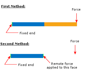

Remote forces are forces that are applied at locations outside of the model. The functionality is illustrated by solving a cantilever beam made of two parts using two methods. In the first method, the cantilever is solved as a regular assembly. In the second method, the part with the force is neglected and the force is applied as a remote force.
