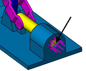

- A 15 lb force applied to the
end of the plunger as shown:
