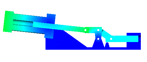

To animate the resultant displacement plot:
  1. Click Back on the Standard Views toolbar.
  2. Right-click Displacement2 (-Res disp-) and select Animate .
  3. In the PropertyManager, under Basics:
    1. Click .
    2. Set Frames to 15.
    3. Click .
    Click this animation to play it or to reset it.
  4. Click .
  5. Click .
