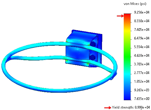

Meshing the Model and Running the Study In the Simulation study tree, right-click Mesh and select Create Mesh . In the PropertyManager, apply the recommended mesh settings. Mesh Parameters settings Standard mesh Selected Global Size Calculated by the mesh algorithm Tolerance Calculated by the mesh algorithm Automatic transition Selected Advanced settings Jacobian points (for solid mesh only) 16 points Automatic trials for solid (for solid mesh only) Selected Number of trials 3 Remesh failed parts independently Selected Mesh Quality High Under Options, select Run (solve) the analysis. Click to accept the values. Click No when prompted to re-run the study with the large displacement option. The mesh is created and the analysis starts. After the analysis completes, you view the Stress 1 (-von Mises-) plot in the Graphics Area. The von Mises stress plot is shown in units of psi. Parent topic Analysis of a Basketball Assembly With Bolts Previous topic Defining Local Interaction Next topic Viewing Resultant Displacement
