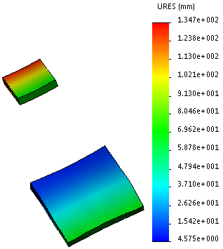

  1. In the Simulation study tree, right-click the Results folder and click Define Displacement Plot .
  2. In the PropertyManager under Display, select mm for Units .
  3. Under Deformed shape, select User defined and enter 1 for Scale Factor .
  4. Click .
    The following resultant displacement plot displays.

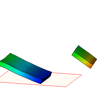

  5. To animate the displacement plot:
    1. In the Simulation study tree, right-click Displacement2 (-Res disp-) and click Animate .
      The animation of the displacement plot shows.
      Click this animation to play it or to reset it.
    2. Click to stop the animation.
