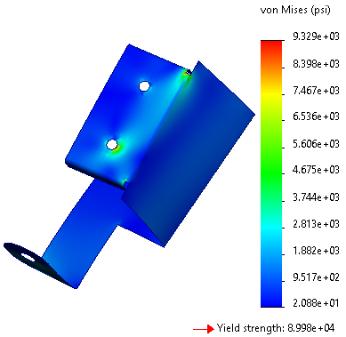

Viewing Stress Results on Bottom Faces In the Simulation study tree, right-click the Results folder and select Define Stress Plot . In the PropertyManager, under Display: Set Units to psi. Set Shell Face to Bottom. Click . Rename this plot to Bottom von Mises in the Simulation study tree. Double-click Bottom von Mises. The equivalent stress plot is displayed on the bottom faces of the model. Note that von Mises stresses at the top and bottom faces are slightly different. Parent topicStatic Analysis of a Sheet Metal Part Previous topic Viewing Stress Results on Top Faces Next topic Viewing Resultant Displacements
