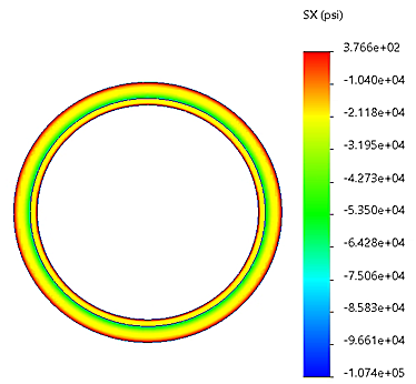

Viewing Radial Stresses You view radial stresses with respect to the reference axis, Axis1. In the Simulation study tree, right-click the Results folder and select Define Stress Plot . In the PropertyManager under Display, select SX: X Normal stress in Component and psi in Units . Under Advanced Options, select Axis1 in the flyout FeatureManager design tree for Plane, Axis or Coordinate System . Clear Deformed shape. Click . Parent topic Shrink Fitting of Two Rings Previous topic Meshing the Model and Running the Study Next topic Listing Radial Stresses
