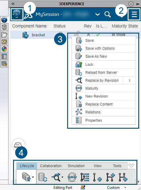

You can view, open, and save the contents of SOLIDWORKS Connected in 3DEXPERIENCE using the MySession widget. MySession displays a tree view of the
active content in the 3DEXPERIENCE tab of SOLIDWORKS Connected.
You can:
1 |
Click the Compass
in the upper left
corner to access more apps, such as the Welcome app. |
2 |
Click the menu in the upper-right corner to access
additional resources and information. |
3 |
Right-click the part name to review the commands
available in the shortcut menu. |
4 |
Use the action bar located at the bottom to access
other functions. |
