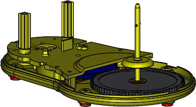

Changing the Sorting Property You can change the property used to sort components. To change the sorting property: Click the arrow to the right of Mass. The flyout list contains some commonly used properties. You can also select from any other custom properties already defined in the components, as demonstrated in the following steps. Click More. In the dialog box, in Properties, select Cost.Cost appears in Column header. Click OK.Cost appears at the top of the property column, and the components are sorted from highest to lowest cost. In the graphics area, the colors of the parts change accordingly. Parent topicAssembly Visualization Previous topic Hiding Components Next topic Creating an Equation for Sorting
