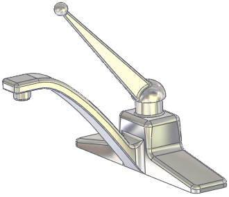

Cast Stainless Steel
Example: Part in cast stainless steel
