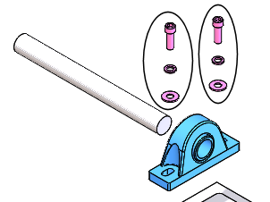

The training assembly is shown in an exploded view to
facilitate component selection.
Click or click Make Smart
Component
(Assembly
toolbar).
Select the bearing for Smart
Component
The bearing (the component that you are making smart) is
highlighted.
Select the cap screws, lock washers, and flat washers for
Components
The cap screws, lock washers, and flat washers are
components that you want to associate with the selected bearing.
