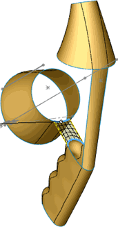

Connecting the Base to the Grip
Next, connect the base to the grip.
  1. Click Lofted Surface on the Surfaces tab.
  2. Select the edges on the base and the grip for Profile in the PropertyManager.
    Check the preview. If the profile is twisted, adjust the connector.
    See step 3 in Lofted Surface - Surface Bodies.
  3. Under Start/End Constraints:
    1. Select Tangency To Face for Start constraint and End constraint.
    2. Set Start Tangent Length to 3 and End Tangent Length to 7.
      Switch the start and end lengths as required, to apply the value of 7 to the side near the grip.
  4. Under Options, select Merge tangent faces.
  5. Click OK .
