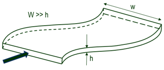

The shell analysis procedure uses two numerical approximations to model
laminar flow:
- Hele-Shaw flow for cavity domains
- Hagen-Poiseuille flow for runner domains
These approximations assume that the flow is always parallel to the solid
boundaries, which means that the shell analysis procedure cannot properly model
cross-stream flow. The shell analysis procedure is further limited to injection
processes that use a single polymer material.
| Hele-Shaw Flow for Shell Analysis |
Hagen-Poiseuille Flow for Shell Analysis |
| Laminar flow between two parallel flat plates
separated
by
a small gap |
Laminar flow in a long cylindrical tube |
