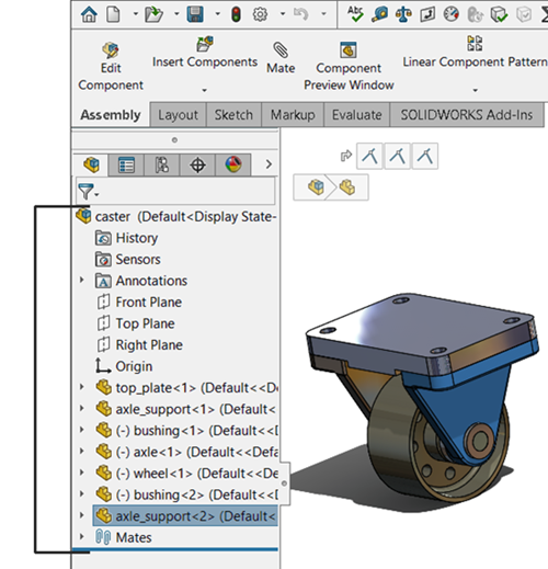

The
FeatureManager design tree provides a tree view of all the sketches and features that
comprise a model.
You start a lot of your editing work by making a selection or activating a
command in the FeatureManager design tree.
Click this animation to play it or to reset
it.
For details in the SOLIDWORKS Connected Help, see FeatureManager Design Tree Overview.
