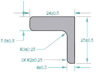

Front view
The instance count (3x) is part of
the R2 radius dimension.

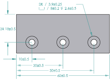

Right view
The instance count and chain dimensions are part of the 3X counterbore hole
pattern.

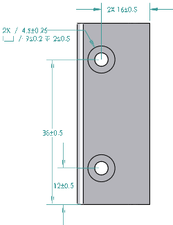

The instance count and chain dimensions are part of the 2X counterbore hole
pattern.
