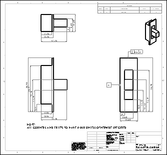

You can create a note, then save it in the Design Library for reuse in other drawings.
  1. Click Note (Annotation tab).
  2. Click in the lower-left corner of the drawing sheet to place the note.
  3. Type NOTE:.
  4. Press Enter.
  5. Type ALL CORNERS AND FILLETS TO HAVE 0.05R UNLESS OTHERWISE SPECIFIED.
  6. Click in the Note PropertyManager.
