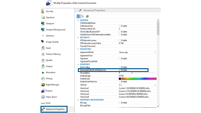

Prevent Outline Generation for Hidden Geometry
The GenerateOutlineForHiddenActor property available in the Viewport category of the Advanced Properties page specifies whether or not hidden actors should be outlined by the render mode.
Benefits: You can ensure that outlines are not generated for hidden actors by clearing this option. This saves time when computing the render mode for large assemblies.
Related topics: Advanced Properties.
