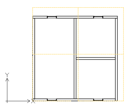

The BIMSplitDrawing command lets you split a specified area of a drawing into multiple equal crop tiles.
Crop tiles that you have specified in the primary view generate a set of so called dependent views. Dependent views provide exact copies of the corresponding crop tile from the primary view.
In the BIM Navigator, dependent views appear grouped under the primary view.
From the BIM Navigator, you can do the following:
  • Display the crop tile for each dependent view. In the graphics area, the corresponding crop tile appears in a dashed line.

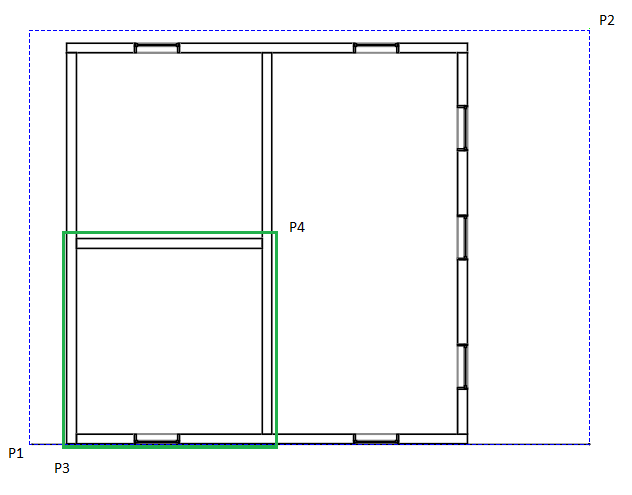

  3. In the graphics area, specify the first corner of the drawing area to split (P1).
  4. Specify the opposite corner of the drawing area to split (P2).
  5. Specify the first corner of the tile (P3).
  6. Specify the opposite corner of the tile (P4).
  7. Specify the point from which to start splitting the rectangular drawing area. For example, P3.
  8. If necessary, specify horizontal and vertical overlapping.
