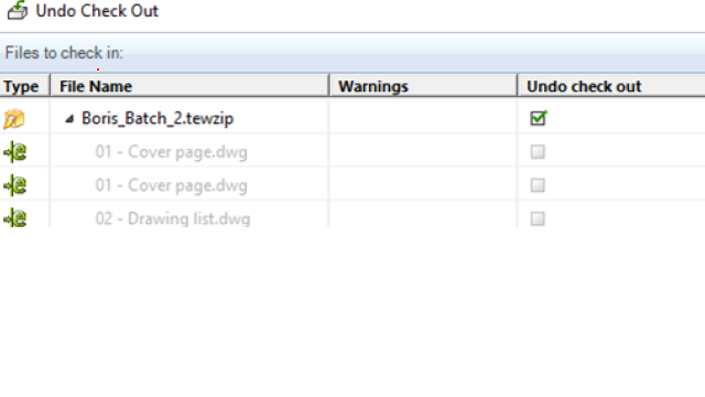

Undoing Check Out
You can cancel a check-out. Any local changes made for SOLIDWORKS Electrical project files are discarded in PDM.
To undo check out:
  1. Select the project files tocancel check out.
  2. Click Undo Check Out.
    Undo Check Out updates and overwrites the project with the latest version in SOLIDWORKS PDM.
