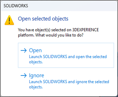

When launching SOLIDWORKS from the 3DEXPERIENCE platform, a user may unintentionally select an object, causing SOLIDWORKS to open it once the session is ready. After SOLIDWORKS starts, a dialog box appears, letting the user to either continue opening the selected object or interrupt the process.
Benefits: This update helps prevent unintended openings when launching SOLIDWORKS.
You can choose:
  • Open: Proceeds with loading the selected object in SOLIDWORKS.
  • Ignore: Opens SOLIDWORKS without loading the object chosen.
The behavior does not apply when launching SOLIDWORKS from a desktop shortcut or script.
