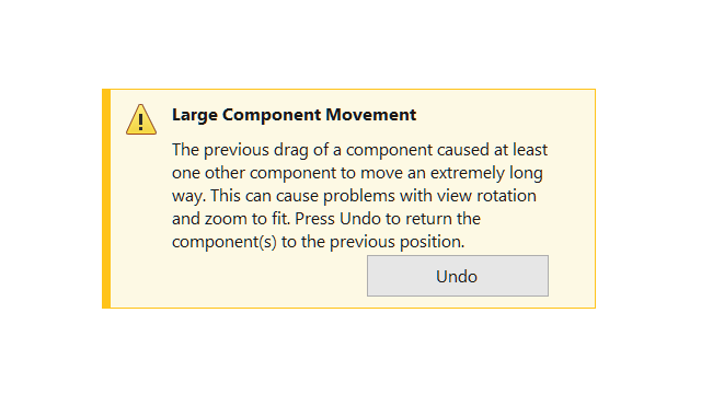

Warning When Moving Components (2025 SP1)
When a component moves a long distance from an assembly, SOLIDWORKS shows a warning message.
In some cases, a small drag of a component or changing mate settings can cause a component to move far away from the assembly.
The long distance between the component and the assembly can cause issues with view rotation and Zoom to Fit .
To return the component to the previous position, click Undo in the notification dialog box or click Edit > Undo Move Component .
