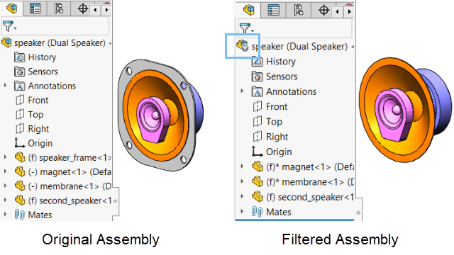

    The selected filtered assembly opens in SOLIDWORKS. In the FeatureManager design tree, at the top node, this icon indicates a filtered assembly. Filtered-out components do not appear in the FeatureManager design tree but the software retains these components in the product structure for subsequent filtering. A notification alerts you that this is a filtered assembly.
