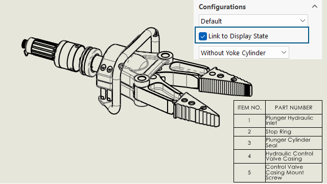

Linking Bills of Materials to Display States (2025 SP1)
In the Bill of Materials (BOM) PropertyManager, you can link a BOM to display states.
Benefits: You can see items in the BOM only for components that are visible in the view.
To link BOMs to display states:
  1. In the Bill of Materials PropertyManager, under Configurations, select Link to Display State.
  2. Click and select a display state.
  3. Click .
