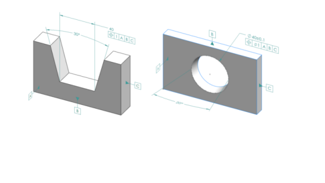

You can create length dimensions in drafted features.
You can use the DimXpert Size Dimension
tool to create dimensions for drafted
features, such as wedges and cones. The dimension is typically a distance dimension with
tolerances. The dimension can be between two edges of draft ends or circular edges of a
cylinder.
Creating Length Dimensions in Cones
To create length dimensions
in
cones:
- Click Size Dimension
(MBD Dimension toolbar)
or .
- Click the conical face to create the cone
feature.
- Place the angle dimension.
- Click the top edge to create the intersect circle feature and diameter
dimension.
See
SOLIDWORKS
Help: DimXpert
Features.
- Apply a
geometric
tolerance to the intersect circle feature to create the
position callout.
