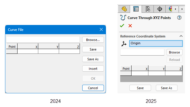

The
functionality uses a PropertyManager in which you can select a different
coordinate system. The points of the curve transform into the space of the coordinate
system.
In earlier releases,
this functionality used a dialog box and could only use the origin of the part for the
curve.
In the PropertyManager, you can:
- Manually enter the XYZ coordinate data.
- Click Browse to select a .sldcrv or
.txt file.
- Click Reload to update
the curve based on any modifications made to the .sldcrv or .txt file used
to create it.
When you open files created before
SOLIDWORKS 2025 and edit curves created by XYZ points, in the PropertyManager, under
Reference Coordinate System, the software
uses the origin for Coordinate System (Origin)
