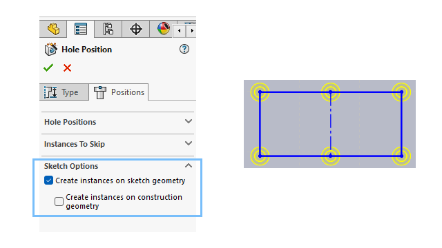

Retaining Hole Wizard Sketch Options (2025 SP3)
For Hole Wizard features, the software retains the Sketch Options settings for new holes, new parts, or new sessions of SOLIDWORKS.
On the Hole Wizard Positions tab, this functionality applies to the options Create instances on sketch geometry and Create instances on construction geometry.
By default, these Sketch Options settings are cleared.
