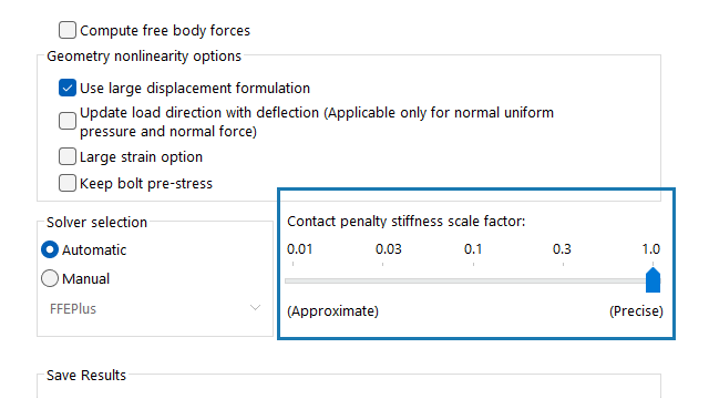

Contact Penalty Stiffness Control for Nonlinear Studies
You can adjust a scale factor for the penalty stiffness applied to surface-to-surface contact interactions when solving nonlinear studies.
The default value for the contact penalty stiffness factor is 1.0, which yields the most accurate solution. To obtain an approximate solution and assess design iterations faster, you can specify a value lower than 1.0.
You can set the study-level scale factor for the penalty stiffness in the Nonlinear- Static dialog box.
