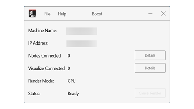

The latest iteration of Visualize Boost boasts a user-friendly setup interface, streamlined machine discovery, and heightened stability.
To install and set up Visualize Boost:
  1. Use the SOLIDWORKS Installation Manager to install Boost on one or multiple machines that are accessible in the network.
  2. On each Boost machine, do the following:
    1. Start SOLIDWORKS Visualize Boost 2025.
    2. Go to File > Settings.
    3. For one machine, select Coordinator to make it the coordinator node. Leave the Coordinator check box clear for all other Boost nodes.
    4. For non-coordinator Boost nodes, enter the Coordinator IP Address.
    5. Click Apply.
  3. ln SOLIDWORKS Visualize, go to Tools > Options > Boost, and enter the Coordinator IP Address.
  4. Click Connect.
Once connected, you can choose the Boost Renderer in the Render Wizard/Quality page to start a render that is distributed over the network.
