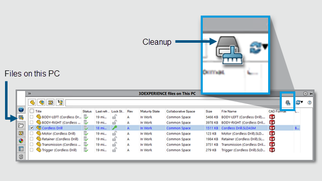

  1. In the Task Pane, click the 3DEXPERIENCE Files on this PC tab. Then click Cleanup in the toolbar.
  2. In the dialog box, select a timeframe to delete files based on their Last Refreshed date on the platform.
