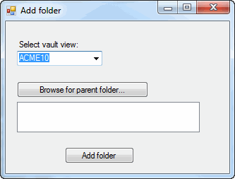

// Postconditions:
// 1. Displays the Add folder dialog box.
//    a. Select a vault view.
//    b. Click Browse for parent folder
//       1. Locate and click a folder in the vault.
//       2. Click OK.
//    c. Click Add folder.
//       1.  Creates an IEdmFolderData5 object with:
//           * Folder user permissions for user, Engineer1.
//           * Folder group permissions for group, Administrators.
//           * File data card for .doc files.
//       2. Displays a message that folder, Temp, is added as a subfolder to
//          the folder clicked in Postconditions 1b1.
//       3. Click OK.
// 2. Close the Add folder dialog box.

        public void BrowseButton_Click(System.Object sender, System.EventArgs e)
            try
                ListBox.Items.Clear();
                if (vault1 == null)
                    vault1 = new EdmVault5();
                if (!vault1.IsLoggedIn)
                    //Log into selected vault as the current user
                    vault1.LoginAuto(VaultsComboBox.Text, this.Handle.ToInt32());
                //Show the Browse For Folder dialog
                System.Windows.Forms.DialogResult DialogResult;
                DialogResult = FolderBrowserDialog1.ShowDialog();
                //If the user didn't click OK, exit
                if (!(DialogResult == System.Windows.Forms.DialogResult.OK))
                    return;
                ListBox.Items.Add(FolderBrowserDialog1.SelectedPath);
            catch (System.Runtime.InteropServices.COMException ex)
                MessageBox.Show("HRESULT = 0x" + ex.ErrorCode.ToString("X") + " " + ex.Message);
            catch (Exception ex)
                MessageBox.Show(ex.Message);
