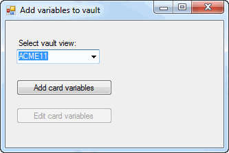

// Postconditions:
// 1. Displays the Add variables to vault dialog box.
// 2. Select a vault view.
// 3. Click Add card variables
//    a. Adds two card variables, MyNewVar and MySecondVar, to the vault.
//    b. Displays a message box with the IDs of the new variables.
//    c. Click OK.
// 4. Click Edit card variables.
//    a. Displays the Edit Variables dialog box.
//    b. Click OK.
//    c. Displays a message box.
//    d. Click OK.
// 5. Close the Add variables to vault dialog box.

            //VaultsLabel
            this.VaultsLabel.AutoSize = true;
            this.VaultsLabel.Location = new System.Drawing.Point(13, 26);
            this.VaultsLabel.Name = "VaultsLabel";
            this.VaultsLabel.Size = new System.Drawing.Size(94, 13);
            this.VaultsLabel.TabIndex = 0;
            this.VaultsLabel.Text = " Select vault view:";
            //VaultsComboBox
            this.VaultsComboBox.FormattingEnabled = true;
            this.VaultsComboBox.Location = new System.Drawing.Point(16, 42);
            this.VaultsComboBox.Name = "VaultsComboBox";
            this.VaultsComboBox.Size = new System.Drawing.Size(121, 21);
            this.VaultsComboBox.TabIndex = 1;
            //AddVaultVars
            this.AddVaultVars.Location = new System.Drawing.Point(16, 86);
            this.AddVaultVars.Name = "AddVaultVars";
            this.AddVaultVars.Size = new System.Drawing.Size(139, 23);
            this.AddVaultVars.TabIndex = 5;
            this.AddVaultVars.Text = "Add card variables";
            this.AddVaultVars.UseVisualStyleBackColor = true;
            this.AddVaultVars.Click +=new System.EventHandler(AddVaultVars_Click);
            //OpenFileDialog
            this.OpenFileDialog.Title = "Open";
            //Button1
            this.Button1.Location = new System.Drawing.Point(16, 127);
            this.Button1.Name = "Button1";
            this.Button1.Size = new System.Drawing.Size(139, 23);
            this.Button1.TabIndex = 6;
            this.Button1.Text = "Edit card variables";
            this.Button1.UseVisualStyleBackColor = true;
            this.Button1.Click +=new System.EventHandler(Button1_Click);
            //Form1
            this.AutoScaleDimensions = new System.Drawing.SizeF(6f, 13f);
            this.AutoScaleMode = System.Windows.Forms.AutoScaleMode.Font;
            this.ClientSize = new System.Drawing.Size(243, 185);
            this.Controls.Add(this.Button1);
            this.Controls.Add(this.AddVaultVars);
            this.Controls.Add(this.VaultsComboBox);
            this.Controls.Add(this.VaultsLabel);
            this.Name = "Form1";
            this.Text = "Add variables to vault";
            this.Load += new System.EventHandler(this.Form1_Load);
            this.ResumeLayout(false);
            this.PerformLayout();
