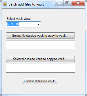

'  1. The Batch add files to vault dialog box displays.
'     a. Select a vault view.
'     b. Click Select file outside vault to copy to vault.
'     c. In the Select File dialog:
'        1. Click a file outside the vault.
'        2. Click Open.
'     d. Click Select file inside vault to copy to vault.
'     e. In the Select File dialog:
'        1. Click a file in the vault.
'        2. Click Open.
'     f. Click Commit all files to vault.
'  2. Click Add in the Batch Items dialog box.
'  3. Click OK to close the message box.
'     Two new folders, Folder1 and Folder2, are created in the vault's
'     root directory. The first selected file is copied to Folder1.
'     The second selected file is copied to Folder2.
'  4. Close the Batch add files to vault dialog box.

        'SelectFileDialog
        Me.SelectFileDialog.Title = "Select File"
        'Form1
        Me.AutoScaleDimensions = New System.Drawing.SizeF(6.0!, 13.0!)
        Me.AutoScaleMode = System.Windows.Forms.AutoScaleMode.Font
        Me.ClientSize = New System.Drawing.Size(284, 291)
        Me.Controls.Add(Me.FileList2)
        Me.Controls.Add(Me.CopyFromVault)
        Me.Controls.Add(Me.FileList1)
        Me.Controls.Add(Me.CopyToVault)
        Me.Controls.Add(Me.BatchAdd)
        Me.Controls.Add(Me.VaultsComboBox)
        Me.Controls.Add(Me.VaultsLabel)
        Me.Name = "Form1"
        Me.Text = "Batch add files to vault"
        Me.ResumeLayout(False)
        Me.PerformLayout()
    End Sub
    Friend WithEvents VaultsLabel As System.Windows.Forms.Label
    Friend WithEvents VaultsComboBox As System.Windows.Forms.ComboBox
    Friend WithEvents BatchAdd As System.Windows.Forms.Button
    Friend WithEvents CopyToVault As System.Windows.Forms.Button
    Friend WithEvents FileList1 As System.Windows.Forms.ListBox
    Friend WithEvents CopyFromVault As System.Windows.Forms.Button
    Friend WithEvents FileList2 As System.Windows.Forms.ListBox
    Friend WithEvents SelectFileDialog As System.Windows.Forms.OpenFileDialog
End Class
