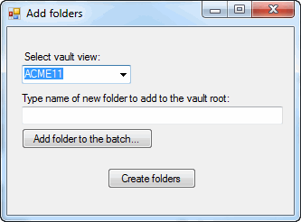

// 1. Displays the Add folders dialog box.
//    a. Select a vault view.
//    b. Type the name of a new folder to create in the root folder
//       of the vault.
//    c. Click Add folder to the batch.
//       1. Displays a message that the folder is added to the batch.
//       2. Click OK.
// 2. Repeat steps 1b-c repeatedly to add more folders to the batch.
// 3. Click Create folders.
//    a. Displays a message that the folder is created.
//    b. Click OK in each message box.
// 4. Close the Add folders dialog box.

            //VaultsLabel
            this.VaultsLabel.AutoSize = true;
            this.VaultsLabel.Location = new System.Drawing.Point(13, 26);
            this.VaultsLabel.Name = "VaultsLabel";
            this.VaultsLabel.Size = new System.Drawing.Size(94, 13);
            this.VaultsLabel.TabIndex = 0;
            this.VaultsLabel.Text = " Select vault view:";

            this.Text = "Add folders";
