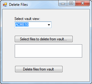

Batch Delete Files and Folders from Vault Example (C#)
This example shows how to delete several files and a folder from the vault in one batch.

// Postconditions:
// 1. The Delete Files dialog box displays.
//    a. Select a vault view.
//    b. Click Select files to delete from vault.
//    c. In the Select File dialog:
//       1. Click a file inside the vault.
//       2. Click Open.
//    d. Click Delete files from vault.
// 2. Click Delete in the Confirm Multiple File Delete dialog box.
//    a. If no errors occur, the selected file and Folder1 are moved
//       from the vault to the SOLIDWORKS PDM recycling bin.
(To see the
//       SOLIDWORKS PDM recycling bin, right-click your vault, click
//       Properties, and click Deleted Items.)
//    b. If an error dialog box pops up, click OK to close it.
// 3. Close the Delete Files dialog box.
