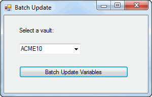

' Postconditions:
'  1. Displays the Batch Update dialog box.
'     a. Select a vault.
'     b. Click Batch Update Variables.
'        * Updates the Title and Comment variables in the data cards
'          only of checked-out text files.
'        * Updates the Description variable of the data cards of all folders
'          with the word Folder in their names.
'        * Displays a message box saying Card variables updated.
'     c. Click OK to close the message box.
'  2. Close the Batch Update dialog box.
'  3. Inspect the data cards of any checked-out text files and folders with
'     the word Folder in their names in the selected vault.
