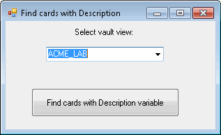

//     Form1.cs in the Solution Explorer.
//  9. Replace the code in Form1.cs with this code. // 10. Replace the code in Form1.Designer.cs with this code. // 11. Add dependencies and safely pass arrays of structures. // 12. Open the Immediate window. // 13. Click Debug > Start Debugging or press F5. // // Postconditions:  //  1. Displays a dialog. //  2. Select a vault. //  3. Click the Find cards with Description variable button. //     The cards in your vault with a Description variable are //     printed to the Immediate window.  //  4. Examine the Immediate window. //  5. Close the dialog. //----------------------------------------------------------------------------

            this.FindCardsButton.Text = "Find cards with Description variable";
            this.FindCardsButton.UseVisualStyleBackColor = true;
            this.FindCardsButton.Click += new System.EventHandler(this.FindCardsButton_Click);

            this.Text = "Find cards with Description";
            this.Load += new System.EventHandler(this.CardsVariableCSharp_Load);
