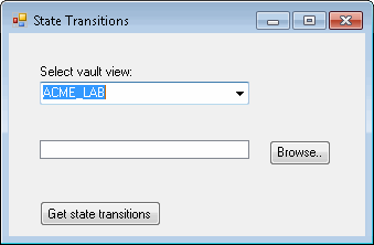

// Postconditions:
// 1. Displays the State Transitions dialog box.
// 2. Select a vault view.
// 3. Click Browse.
// 4. Displays the Select a file dialog box.
//    a. Select a file in the selected vault.
//    b. Click Open.
//    The selected file's path and file name appear
//    in the Select a file dialog box.
// 5. Click Get state transitions
// 6. Displays a message box showing the name of the selected
//    file and its current and next possible state transitions.
// 7. Click OK to close the message box.

        private void InitializeComponent()
            this.VaultsLabel = new System.Windows.Forms.Label();
            this.VaultsComboBox = new System.Windows.Forms.ComboBox();
            this.FileListBox = new System.Windows.Forms.ListBox();
            this.BrowseButton = new System.Windows.Forms.Button();
            this.GetTransitionButton = new System.Windows.Forms.Button();
            this.OpenFileDialog1 = new System.Windows.Forms.OpenFileDialog();
            this.SuspendLayout();
            // VaultsLabel
            this.VaultsLabel.AutoSize = true;
            this.VaultsLabel.Location = new System.Drawing.Point(13, 22);
            this.VaultsLabel.Name = "VaultsLabel";
            this.VaultsLabel.Size = new System.Drawing.Size(91, 13);
            this.VaultsLabel.TabIndex = 0;
            this.VaultsLabel.Text = "Select vault view:";
            // VaultsComboBox
            this.VaultsComboBox.FormattingEnabled = true;
            this.VaultsComboBox.Location = new System.Drawing.Point(16, 39);
            this.VaultsComboBox.Name = "VaultsComboBox";
            this.VaultsComboBox.Size = new System.Drawing.Size(221, 21);
            this.VaultsComboBox.TabIndex = 1;
            // FileListBox
            this.FileListBox.FormattingEnabled = true;
            this.FileListBox.Location = new System.Drawing.Point(16, 96);
            this.FileListBox.Name = "FileListBox";
            this.FileListBox.Size = new System.Drawing.Size(179, 30);
            this.FileListBox.TabIndex = 2;
            // BrowseButton
            this.BrowseButton.Location = new System.Drawing.Point(209, 96);
            this.BrowseButton.Name = "BrowseButton";
            this.BrowseButton.Size = new System.Drawing.Size(75, 23);
            this.BrowseButton.TabIndex = 3;
            this.BrowseButton.Text = "Browse...";
            this.BrowseButton.UseVisualStyleBackColor = true;
            this.BrowseButton.Click += new System.EventHandler(BrowseButton_Click);
            // GetTransitionButton
            this.GetTransitionButton.Location = new System.Drawing.Point(16, 150);
            this.GetTransitionButton.Name = "GetTransitionButton";
            this.GetTransitionButton.Size = new System.Drawing.Size(188, 23);
            this.GetTransitionButton.TabIndex = 4;
            this.GetTransitionButton.Text = "Get next possible state transitions";
            this.GetTransitionButton.TextAlign = System.Drawing.ContentAlignment.MiddleLeft;
            this.GetTransitionButton.UseVisualStyleBackColor = true;
            this.GetTransitionButton.Click += new System.EventHandler(GetTransitionButton_Click);
            //OpenFileDialog1
            this.OpenFileDialog1.FileName = "OpenFileDialog1";
            this.OpenFileDialog1.Multiselect = true;
            this.OpenFileDialog1.Title = "Select a file";
            // Form1
            this.AutoScaleDimensions = new System.Drawing.SizeF(6F, 13F);
            this.AutoScaleMode = System.Windows.Forms.AutoScaleMode.Font;
            this.ClientSize = new System.Drawing.Size(284, 200);
            this.Controls.Add(this.GetTransitionButton);
            this.Controls.Add(this.BrowseButton);
            this.Controls.Add(this.FileListBox);
            this.Controls.Add(this.VaultsComboBox);
            this.Controls.Add(this.VaultsLabel);
            this.Name = "Form1";
            this.Text = "Workflow State Transitions";
            this.ResumeLayout(false);
