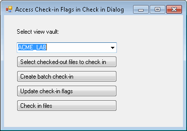

'  4. Ensure that a file in the targeted vault is checked out by a user
'     other than Admin.
'  5. Log into the targeted vault as Admin.
'  6. Click Debug > Start Debugging or press F5.
' Postconditions:
' 1. Displays the Access Check-in Flags in Check in Dialog dialog box.
' 2. Select the vault view where you are logged in as Admin.
' 3. Click Select checked-out files to check in.
'    a. Displays the Select files dialog box.
'    b. Select the file verified as checked out by a user other than
'       Admin.
'    c. Click Open.
' 4. Click Create batch check-in
'    a. Displays message boxes with callback information.
'    b. Click OK to close each message box.
'    c. Displays a message box verifying that the batch check-in
'       was created.
'    d. Click OK to close the message box.
' 5. Click Update check-in flags.
'    a. Displays a message box verifying that check-in flags were updated.
'    b. Click OK to close the message box.
' 6. Click Check in files.
'    a. Displays the Check in dialog box.
'    b. Select the Check in check box.
'    c. Click the Check in button.
'    d. Displays message boxes with callback information.
'    e. Click OK to close each message box.
'    f. Displays an error message informing you that the file is not
'       checked out by Admin.
'    g. Click OK to close the error message.
' 7. Open a File Explorer view of the selected vault and verify that the
'    file that you selected to check in is still checked out.
' 8. Close the Access Check-in Flags in Check in Dialog dialog box.

        'VaultsLabel
        Me.VaultsLabel.AutoSize = True
        Me.VaultsLabel.Location = New System.Drawing.Point(22, 26)
        Me.VaultsLabel.Name = "VaultsLabel"
        Me.VaultsLabel.Size = New System.Drawing.Size(91, 13)
        Me.VaultsLabel.TabIndex = 0
        Me.VaultsLabel.Text = "Select view vault:"
        'VaultsComboBox
        Me.VaultsComboBox.FormattingEnabled = True
        Me.VaultsComboBox.Location = New System.Drawing.Point(25, 54)
        Me.VaultsComboBox.Name = "VaultsComboBox"
        Me.VaultsComboBox.Size = New System.Drawing.Size(199, 21)
        Me.VaultsComboBox.TabIndex = 1
        'BrowseButton
        Me.BrowseButton.Location = New System.Drawing.Point(25, 81)
        Me.BrowseButton.Name = "BrowseButton"
        Me.BrowseButton.Size = New System.Drawing.Size(199, 23)
        Me.BrowseButton.TabIndex = 2
        Me.BrowseButton.Text = "Select checked-out files to check in"
        Me.BrowseButton.TextAlign = System.Drawing.ContentAlignment.MiddleLeft
        Me.BrowseButton.UseVisualStyleBackColor = True
        'CreateBatchCheckinButton
        Me.CreateBatchCheckinButton.Location = New System.Drawing.Point(25, 110)
        Me.CreateBatchCheckinButton.Name = "CreateBatchCheckinButton"
        Me.CreateBatchCheckinButton.Size = New System.Drawing.Size(199, 23)
        Me.CreateBatchCheckinButton.TabIndex = 3
        Me.CreateBatchCheckinButton.Text = "Create batch check-in"
        Me.CreateBatchCheckinButton.TextAlign = System.Drawing.ContentAlignment.MiddleLeft
        Me.CreateBatchCheckinButton.UseVisualStyleBackColor = True
        'UpdateBatchCheckInButton
        Me.UpdateBatchCheckInButton.Location = New System.Drawing.Point(25, 139)
        Me.UpdateBatchCheckInButton.Name = "UpdateBatchCheckInButton"
        Me.UpdateBatchCheckInButton.Size = New System.Drawing.Size(199, 23)
        Me.UpdateBatchCheckInButton.TabIndex = 4
        Me.UpdateBatchCheckInButton.Text = "Update check-in flags"
        Me.UpdateBatchCheckInButton.TextAlign = System.Drawing.ContentAlignment.MiddleLeft
        Me.UpdateBatchCheckInButton.UseVisualStyleBackColor = True
        'CheckInButton
        Me.CheckInButton.Location = New System.Drawing.Point(25, 168)
        Me.CheckInButton.Name = "CheckInButton"
        Me.CheckInButton.Size = New System.Drawing.Size(199, 23)
        Me.CheckInButton.TabIndex = 5
        Me.CheckInButton.Text = "Check in files"
        Me.CheckInButton.TextAlign = System.Drawing.ContentAlignment.MiddleLeft
        Me.CheckInButton.UseVisualStyleBackColor = True
        'Form1
        Me.AutoScaleDimensions = New System.Drawing.SizeF(6.0!, 13.0!)
        Me.AutoScaleMode = System.Windows.Forms.AutoScaleMode.Font
        Me.ClientSize = New System.Drawing.Size(355, 222)
        Me.Controls.Add(Me.CheckInButton)
        Me.Controls.Add(Me.UpdateBatchCheckInButton)
        Me.Controls.Add(Me.CreateBatchCheckinButton)
        Me.Controls.Add(Me.BrowseButton)
        Me.Controls.Add(Me.VaultsComboBox)
        Me.Controls.Add(Me.VaultsLabel)
        Me.Name = "Form1"
        Me.Text = "Access Check-in Flags in Check in Dialog"
        Me.ResumeLayout(False)
        Me.PerformLayout()
    End Sub
