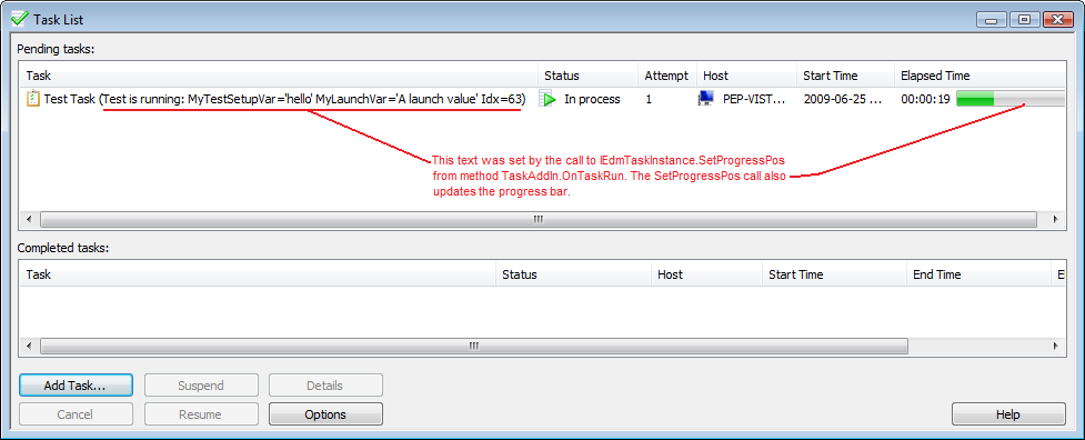

Private Sub OnTaskRun(ByRef poCmd As EdmCmd, ByRef ppoData As EdmCmdData[])
  'Get the property interface used to access the framework
  Dim inst As IEdmTaskInstance
  inst = poCmd.mpoExtra
  On Error GoTo ErrHand
  'Inform the framework that the task has started
  inst.SetStatus(EdmTaskStatus.EdmTaskStat_Running)
  'Format a message to be displayed in the task list
  Dim msg As String
  msg = "Test is running:"
  msg = msg + " MyTestSetupVar='" + CStr(inst.GetValEx("MyTestSetupVar"))
  msg = msg + "' MyLaunchVar='" + inst.GetValEx("MyLaunchVar")
  msg = msg + "' Idx="
  'This is the main worker loop that does all of the important work;
  'it just beeps and sleeps
  Dim idx As Integer
  idx = 1
  Dim maxPos As Integer
  maxPos = 200
  inst.SetProgressRange(maxPos, 0, msg + CStr(idx))
  While idx < maxPos
    'Update progress bar that shows in the task list
    inst.SetProgressPos(idx, msg + CStr(idx))
    idx = idx + 1
    'Do some important work here
    System.Media.SystemSounds.Beep.Play()
    System.Threading.Thread.Sleep(60000 / maxPos)
    'Handle the cancel button in the task list
    If inst.GetStatus() = EdmTaskStatus.EdmTaskStat_CancelPending Then
      inst.SetStatus(EdmTaskStatus.EdmTaskStat_DoneCancelled)
      Exit Sub
    End If
    'Handle temporary suspension of the task
    If inst.GetStatus() = EdmTaskStatus.EdmTaskStat_SuspensionPending Then
      inst.SetStatus(EdmTaskStatus.EdmTaskStat_Suspended)
      While inst.GetStatus() = EdmTaskStatus.EdmTaskStat_Suspended
        System.Threading.Thread.Sleep(1000)
      End While
      If inst.GetStatus() = EdmTaskStatus.EdmTaskStat_ResumePending Then
      End If
    End If
  End While
  'Inform the framework that the task has successfully
completed
  inst.SetStatus(EdmTaskStatus.EdmTaskStat_DoneOK)
  Exit Sub
ErrHand:
  'Return errors to the framework by failing the task
  inst.SetStatus(EdmTaskStatus.EdmTaskStat_DoneFailed, Err.Number, "The test task failed!")
End Sub

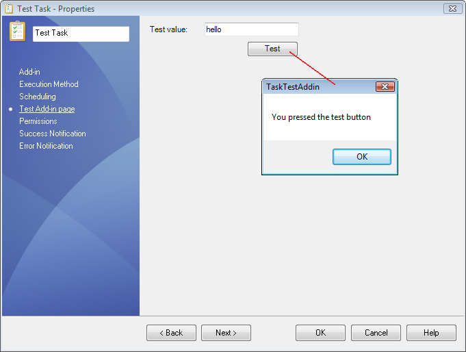

The following is a resource template of the custom set-up page that is displayed in the Task property dialog box by TaskAddIn::OnTaskSetup. It is a user control in Visual Studio with an edit box named TextBox1 and a button named TestButton.
The code behind the custom set-up page is as follows.

'Button handler for a button on the page
Private Sub TestButton_Click(ByVal sender As System.Object, ByVal e As System.EventArgs) Handles TestButton.Click
  MsgBox("You pressed the test button")
End Sub

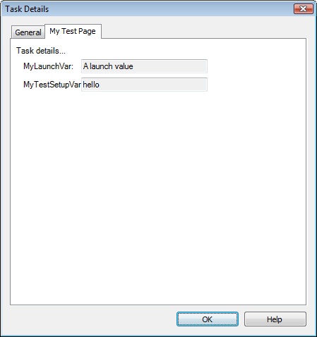

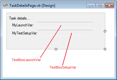

The following is the resource template of the extra details page added by TaskAddIn::OnTaskDetails. It is a user control in Visual Studio that displays two task variables:
The code behind the extra details page:
Imports EPDM.Interop.epdm
Public Class TaskDetailsPage
Public Sub LoadData(ByRef inst As IEdmTaskInstance)
  'Populate the editboxes from the variables in the task
  TextBoxSetupVar.Text = CStr(inst.GetValEx("MyTestSetupVar"))
  TextBoxLaunchVar.Text = CStr(inst.GetValEx("MyLaunchVar"))
End Sub
End Class

The following is the task details page when opened from the task list.
The following is the task list during task execution.
