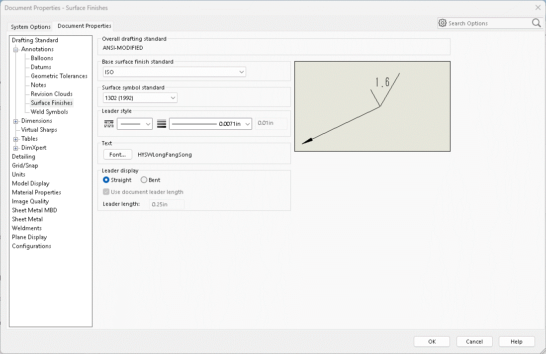

Document Properties > Annotations > Surface Finishes
Setting
Get/Set Methods
Return Value or <Value>
Comments
Base surface finish standard
IModelDocExtension::GetUserPreferenceInteger(swUserPreferenceIntegerValue_e.swDetailingDimensionStandard, swUserPreferenceOption_e.swDetailingSurfaceFinishSymbol)
IModelDocExtension::SetUserPreferenceInteger(swUserPreferenceIntegerValue_e.swDetailingDimensionStandard, swUserPreferenceOption_e.swDetailingSurfaceFinishSymbol, swDetailingStandard_e.<Value>)
See swDetailingStandard_e for valid options
Specifies the base surface finish standard to use
Surface symbol standard
IModelDocExtension::GetUserPreferenceInteger(swUserPreferenceIntegerValue_e.swDetailingSFSymbolStandard, swUserPreferenceOption_e.swDetailingNoOptionSpecified)
IModelDocExtension::SetUserPreferenceInteger(swUserPreferenceIntegerValue_e.swDetailingSFSymbolStandard, swUserPreferenceOption_e.swDetailingNoOptionSpecified, swDetailingSFSymbolStandard_e.<Value>)
See  swDetailingSFSymbolStandard_e for valid options
Leader style - Leader Style
IModelDocExtension::GetUserPreferenceInteger(swUserPreferenceIntegerValue_e.swDetailingSFSymbolLeaderLineStyle, swUserPreferenceOption_e.swDetailingNoOptionSpecified)
IModelDocExtension::SetUserPreferenceInteger(swUserPreferenceIntegerValue_e.swDetailingSFSymbolLeaderLineStyle, swUserPreferenceOption_e.swDetailingNoOptionSpecified, swLineStyles_e.<Value>)
See swLineStyles_e for valid options
Leader style - Leader Thickness
IModelDocExtension::GetUserPreferenceInteger(swUserPreferenceIntegerValue_e.swDetailingSFSymbolLeaderLineThickness, swUserPreferenceOption_e.swDetailingNoOptionSpecified)
IModelDocExtension::SetUserPreferenceInteger(swUserPreferenceIntegerValue_e.swDetailingSFSymbolLeaderLineThickness, swUserPreferenceOption_e.swDetailingNoOptionSpecified, swLineWeights_e.<Value>)
See swLineWeights_e for valid options
Leader style - Custom thickness
IModelDocExtension::GetUserPreferenceDouble(swUserPreferenceDoubleValue_e.swDetailingSFSymbolLeaderLineThicknessCustom, swUserPreferenceOption_e.swDetailingNoOptionSpecified)
IModelDocExtension::SetUserPreferenceDouble(swUserPreferenceDoubleValue_e.swDetailingSFSymbolLeaderLineThicknessCustom, swUserPreferenceOption_e.swDetailingNoOptionSpecified, <Value>)
Double value
Specifies custom thickness of surface finish symbol leader lines; sets Custom Thickness to the specified thickness and Leader Thickness to Custom Size
Text - Font...
IModelDocExtension::GetUserPreferenceTextFormat(swUserPreferenceTextFormat_e.swDetailingSurfaceFinishTextFormat, swUserPreferenceOption_e.swDetailingNoOptionSpecified)
IModelDocExtension::SetUserPreferenceTextFormat(swUserPreferenceTextFormat_e.swDetailingSurfaceFinishTextFormat, swUserPreferenceOption_e.swDetailingNoOptionSpecified, <Value>)
See ITextFormat for font options
To set font property values, implement ITextFormat, set the appropriate ITextFormat member values, and pass the ITextFormat object in the API set method
Leader display - Straight or Bent
IModelDocExtension::GetUserPreferenceInteger(swUserPreferenceIntegerValue_e.swDetailingSFSymbolLeaderStyle, swUserPreferenceOption_e.swDetailingNoOptionSpecified)
IModelDocExtension::SetUserPreferenceInteger(swUserPreferenceIntegerValue_e.swDetailingSFSymbolLeaderStyle, swUserPreferenceOption_e.swDetailingNoOptionSpecified, swLeaderStyle_e.<Value>)
See swLeaderStyle_e for valid options
Specifies notes leader style
Leader display - Use document leader length
IModelDocExtension::GetUserPreferenceToggle(swUserPreferenceToggle_e.swDetailingSFSymbolUseDocBentLeaderLength, swUserPreferenceOption_e.swDetailingNoOptionSpecified)
IModelDocExtension::SetUserPreferenceToggle(swUserPreferenceToggle_e.swDetailingSFSymbolUseDocBentLeaderLength, swUserPreferenceOption_e.swDetailingNoOptionSpecified, <Value>)
Boolean value
Specifies whether to use document bent leader lengths for annotations
Leader display - Leader length
IModelDocExtension::GetUserPreferenceDouble(swUserPreferenceDoubleValue_e.swDetailingSFSymbolBentLeaderLength, swUserPreferenceOption_e.swDetailingNoOptionSpecified)
IModelDocExtension::SetUserPreferenceDouble(swUserPreferenceDoubleValue_e.swDetailingSFSymbolBentLeaderLength, swUserPreferenceOption_e.swDetailingNoOptionSpecified, <Value>)
Double value
Specifies the length of surface finish symbol leader lines in a drawing document
Display symbols per 2002
IModelDocExtension::GetUserPreferenceToggle(swUserPreferenceToggle_e.swDetailingDisplaySFSymbolsPer2002, swUserPreferenceOption_e.swDetailingNoOptionSpecified)
IModelDocExtension::SetUserPreferenceToggle(swUserPreferenceToggle_e.swDetailingDisplaySFSymbolsPer2002, swUserPreferenceOption_e.swDetailingNoOptionSpecified, <Value>)
Boolean value
Specifies whether to use 2002 standard to display surface finish symbols
Layer
IModelDocExtension::GetUserPreferenceString(swUserPreferenceStringValue_e.swDetailingLayer, swuserPreferenceOption_e.swDetailingSurfaceFinishSymbol)
IModelDocExtension::SetUserPreferenceString(swUserPreferenceStringValue_e.swDetailingLayer, swuserPreferenceOption_e.swDetailingSurfaceFinishSymbol, <Value>)
String value
Specifies the name of the layer to apply settings to; this setting is available only on drawings
