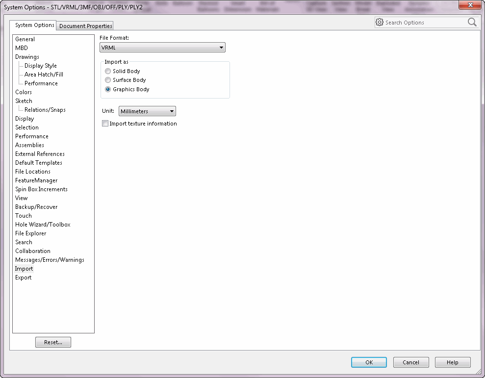

To display the dialog:
Select Tools > Options > System Options > Import > File Format > VRML or 3MF.
- or -
Setting
Get/Set Methods
Return Value or <Value> or <OnFlag>
Comment
Import as - Graphics body
ISldWorks::GetUserPreferenceIntegerValue(swUserPerferenceIntegerValue_e.swImportStlVrmlModelType) ISldWorks::SetUserPreferenceIntegerValue(swUserPerferenceIntegerValue_e.swImportStlVrmlModelType, swImportStlVrmlModelType_e.swImportStlVrmlModelType_Graphics)
Import as - Solid body
ISldWorks::GetUserPreferenceIntegerValue(swUserPerferenceIntegerValue_e.swImportStlVrmlModelType) ISldWorks::SetUserPreferenceIntegerValue(swUserPerferenceIntegerValue_e.swImportStlVrmlModelType, swImportStlVrmlModelType_e.swImportStlVrmlModelType_Solid)
Import as - Surface body
ISldWorks::GetUserPreferenceIntegerValue(swUserPerferenceIntegerValue_e.swImportStlVrmlModelType) ISldWorks::SetUserPreferenceIntegerValue(swUserPerferenceIntegerValue_e.swImportStlVrmlModelType, swImportStlVrmlModelType_e.swImportStlVrmlModelType_Surface)
Unit
ISldWorks::GetUserPreferenceIntegerValue(swUserPerferenceIntegerValue_e.swImportStlVrmlUnits) ISldWorks::SetUserPreferenceIntegerValue(swUserPerferenceIntegerValue_e.swImportStlVrmlUnits, swLengthUnit_e.<Value>)
Valid options from swLengthUnit_e:
0 = swMM (millimeters)
1 = swCM (centimeters)
2 = swMETER
3 = swINCHES
4 = swFEET
Import texture information
ISldWorks::GetUserPreferenceToggle(swUserPreferenceToggle_e.swImportStlVrmlTextureInformation)
ISldWorks::SetUserPreferenceToggle(swUserPreferenceToggle_e.swImportStlVrmlTextureInformation, <OnFlag>)
Boolean value
