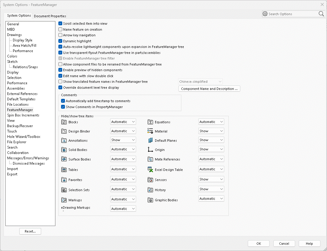

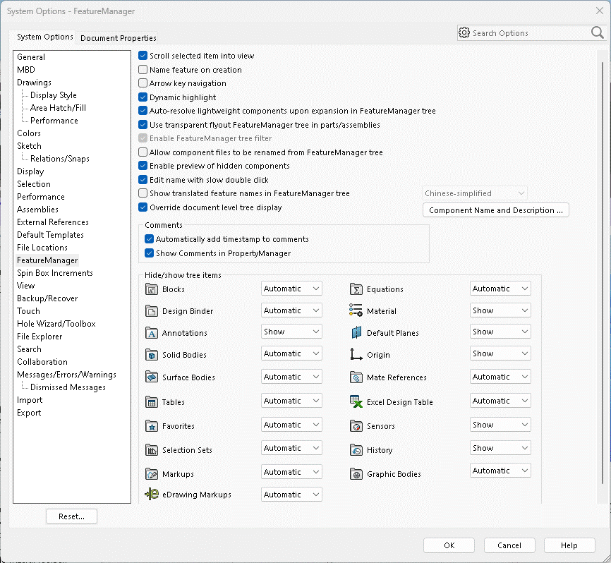

System Options > FeatureManager
Setting
Get/Set Methods
Return Value
or
<Value>
or
<OnFlag>
Comment
Scroll selected item into view
ISldWorks::GetUserPreferenceToggle(swUserPreferenceToggle_e.swFeatureManagerEnsureVisible)
ISldWorks::SetUserPreferenceToggle(swUserPreferenceToggle_e.swFeatureManagerEnsureVisible, <OnFlag>)
Boolean value
Specifies whether FeatureManager design tree should automatically scroll to display feature icon related to selected items in graphics area
Name feature on creation
ISldWorks::GetUserPreferenceToggle(swUserPreferenceToggle_e.swFeatureManagerNameFeatureWhenCreated)
ISldWorks::SetUserPreferenceToggle(swUserPreferenceToggle_e.swFeatureManagerNameFeatureWhenCreated, <OnFlag>)
Boolean value
Specifies to automatically select new feature in FeatureManager design tree to name it
Arrow key navigation
ISldWorks::GetUserPreferenceToggle(swUserPreferenceToggle_e.swFeatureManagerKeyboardNavigation)
ISldWorks::SetUserPreferenceToggle(swUserPreferenceToggle_e.swFeatureManagerKeyboardNavigation, <OnFlag>)
Boolean value
Specifies whether arrow keys can be used to traverse FeatureManager design tree, and expand or collapse design tree and its contents
Dynamic highlight
ISldWorks::GetUserPreferenceToggle(swUserPreferenceToggle_e.swFeatureManagerDynamicHighlight)
ISldWorks::SetUserPreferenceToggle(swUserPreferenceToggle_e.swFeatureManagerDynamicHighlight, <OnFlag>)
Boolean value
Specifies whether geometry in graphics area is highlighted when pointer passes over item in FeatureManager design tree
Auto-resolve lightweight components upon expansion in FeatureManager tree
ISldWorks::GetUserPreferenceToggle(swUserPreferenceToggle_e.swAutoResolveLightweightCompUponExpInFMTree)
ISldWorks::SetUserPreferenceToggle(swUserPreferenceToggle_e.swAutoResolveLightweightCompUponExpInFMTree, <OnFlag>)
Boolean value
Specifies whether to automatically resolve lightweight components when they are expanded in the FeatureManager design tree
Use transparent flyout FeatureManager tree in parts/assemblies
ISldWorks::GetUserPreferenceToggle(swUserPreferenceToggle_e.swFeatureManagerTransparentFlyout)
ISldWorks::SetUserPreferenceToggle(swUserPreferenceToggle_e.swFeatureManagerTransparentFlyout, <OnFlag>)
Boolean value
Specifies whether to use transparent flyout FeatureManager in part and assembly documents
Enable FeatureManager tree filter
ISldWorks::GetUserPreferenceToggle(swUserPreferenceToggle_e.swFeatureManagerEnableTreeFilter)
ISldWorks::SetUserPreferenceToggle(swUserPreferenceToggle_e.swFeatureManagerEnableTreeFilter, <OnFlag>)
Boolean value
Specifies whether to display the FeatureManager design tree filter
Unlike the user interface, you can turn this setting on or off when a model document is open
Allow component files to be renamed from FeatureManager tree
(Not supported in SOLIDWORKS Connected)
ISldWorks::GetUserPreferenceToggle(swUserPreferenceToggle_e.swFeatureManagerEnableRenamingComponent)
ISldWorks::SetUserPreferenceToggle(swUserPreferenceToggle_e.swFeatureManagerEnableRenamingComponent, <OnFlag>)
Boolean value
Specifies whether to enable renaming components
Enable preview of hidden components
ISldWorks::GetUserPreferenceToggle(swUserPreferenceToggle_e.swFeatureManagerEnablePreviewHiddenComponents)
ISldWorks::SetUserPreferenceToggle(swUserPreferenceToggle_e.swFeatureManagerEnablePreviewHiddenComponents, <OnFlag>)
Boolean value
Specifies whether to enable preview of hidden components
Edit name with slow double click
ISldWorks::GetUserPreferenceToggle(swUserPreferenceToggle_e.swEditNameWithSlowDoubleClick)
ISldWorks::SetUserPreferenceToggle(swUserPreferenceToggle_e.swEditNameWithSlowDoubleClick, <OnFlag>)
Boolean value
Show translated feature names in FeatureManager tree
ISldWorks::GetUserPreferenceToggle(swUserPreferenceToggle_e.swFeatureManagerShowTranslatedNameInFMTree)
ISldWorks::SetUserPreferenceToggle(swUserPreferenceToggle_e.swFeatureManagerShowTranslatedNameInFMTree, <OnFlag>)
Boolean value
Language drop-down
ISldWorks::GetUserPreferenceIntegerValue(swUserPreferenceIntegerValue_e.swFeatureManagerTranslatedLanguage)
ISldWorks::SetUserPreferenceIntegerValue(swUserPreferenceIntegerValue_e.swFeatureManagerTranslatedLanguage, swAutoHideShowResponse_e.<Value>)
See swUserPreferencesLanguages_e for valid options
Valid only if swUserPreferenceToggle_e.swFeatureManagerShowTranslatedNameInFMTree is set to true.
Override document level tree display
ISldWorks::GetUserPreferenceToggle(swUserPreferenceToggle_e.swOverrideTreeDisplaySysSettings)
ISldWorks::SetUserPreferenceToggle(swUserPreferenceToggle_e.swOverrideTreeDisplaySysSettings, <OnFlag>)
Boolean value
Specifies whether to override document level display settings with system level display settings. If this toggle is set to true, all the dialog options in the Component Name and Description dialog launched at the document level from the FeatureManager design tree are disabled.

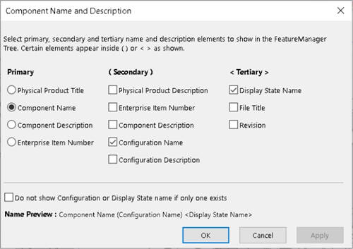

Component Name and Description - Primary -
Physical Product Title
Component Name
Component Description
Enterprise Item Number
ISldWorks::GetUserPreferenceIntegerValue(swUserPreferenceIntegerValue_e.swPrimaryComponentIdentifier)
ISldWorks::SetUserPreferenceIntegerValue(swUserPreferenceIntegerValue_e.swPrimaryComponentIdentifier, swComponentIdentifier_e.<Value>)
Valid options in swComponentIdentifier_e:
swComponentIdentifier_PhysicalProductTitle
swComponentIdentifier_ComponentName
swComponentIdentifier_ComponentDescription
swComponentIdentifier_EnterpriseItemNumber
Valid only if swUserPreferenceToggle_e.swOverrideTreeDisplaySysSettings is set to true.
Component Name and Description - (Secondary) - Physical Product Description
ISldWorks::GetUserPreferenceToggle(swUserPreferenceToggle_e.swSecondaryPhysicalProductDescription)
ISldWorks::SetUserPreferenceToggle(swUserPreferenceToggle_e.swSecondaryPhysicalProductDescription, <OnFlag>)
Boolean value
Valid only for SOLIDWORKS Connected and when  swUserPreferenceToggle_e.swOverrideTreeDisplaySysSettings is set to true
Component Name and Description - (Secondary) - Enterprise Item Number
ISldWorks::GetUserPreferenceToggle(swUserPreferenceToggle_e.swSecondaryEnterpriseItemNumber)
ISldWorks::SetUserPreferenceToggle(swUserPreferenceToggle_e.swSecondaryEnterpriseItemNumber, <OnFlag>)
Boolean value
Valid only:
for SOLIDWORKS Connected,
when  swUserPreferenceToggle_e.swOverrideTreeDisplaySysSettings is set to true,
- and -
when swUserPreferenceIntegerValue_e.swPrimaryComponentIdentifier is not set to swComponentIdentifier_e.swComponentIdentifier_EnterpriseItemNumber
Component Name and Description - (Secondary) - Component Description
ISldWorks::GetUserPreferenceToggle(swUserPreferenceToggle_e.swSecondaryComponentDescription)
ISldWorks::SetUserPreferenceToggle(swUserPreferenceToggle_e.swSecondaryComponentDescription, <OnFlag>)
Boolean value
Valid only:
- and -
when swUserPreferenceIntegerValue_e.swPrimaryComponentIdentifier is not set to swComponentIdentifier_e.swComponentIdentifier_ComponentDescription
Component Name and Description - (Secondary) - Component Name
ISldWorks::GetUserPreferenceToggle(swUserPreferenceToggle_e.swSecondaryComponentName)
ISldWorks::SetUserPreferenceToggle(swUserPreferenceToggle_e.swSecondaryComponentName, <OnFlag>)
Boolean value
Valid only when swUserPreferenceToggle_e.swOverrideTreeDisplaySysSettings is set to true
Component Name and Description - (Secondary) - Configuration Description
ISldWorks::GetUserPreferenceToggle(swUserPreferenceToggle_e.swSecondaryConfigurationName)
ISldWorks::SetUserPreferenceToggle(swUserPreferenceToggle_e.swSecondaryConfigurationName, <OnFlag>)
Boolean value
Component Name and Description - <Tertiary> - Display State Name
ISldWorks::GetUserPreferenceToggle(swUserPreferenceToggle_e.swTertiaryDisplayStateName)
ISldWorks::SetUserPreferenceToggle(swUserPreferenceToggle_e.swTertiaryDisplayStateName, <OnFlag>)
Boolean value
Component Name and Description - <Tertiary> - File Title
ISldWorks::GetUserPreferenceToggle(swUserPreferenceToggle_e.swTertiaryFileTitle)
ISldWorks::SetUserPreferenceToggle(swUserPreferenceToggle_e.swTertiaryFileTitle, <OnFlag>)
Boolean value
Component Name and Description - <Tertiary> - Revision
ISldWorks::GetUserPreferenceToggle(swUserPreferenceToggle_e.swTertiaryRevision)
ISldWorks::SetUserPreferenceToggle(swUserPreferenceToggle_e.swTertiaryRevision, <OnFlag>)
Boolean value
Component Name and Description - Do not show Configuration or Display State name if only one exists
ISldWorks::GetUserPreferenceToggle(swUserPreferenceToggle_e.swDoNotShowConfigOrDisplayStateName)
ISldWorks::SetUserPreferenceToggle(swUserPreferenceToggle_e.swDoNotShowConfigOrDisplayStateName, <OnFlag>)
Boolean value
Comments -  Automatically add timestamp to comments
ISldWorks::GetUserPreferenceToggle(swUserPreferenceToggle_e.swCollabAddTimeStampToComments)
ISldWorks::SetUserPreferenceToggle(swUserPreferenceToggle_e.swCollabAddTimeStampToComments, <OnFlag>)
Boolean value
Comments - Show Comments in PropertyManager
ISldWorks::GetUserPreferenceToggle(swUserPreferenceToggle_e.swCollabShowCommentsInPropertyManager)
ISldWorks::SetUserPreferenceToggle(swUserPreferenceToggle_e.swCollabShowCommentsInPropertyManager, <OnFlag>)
Boolean value
Select a configuration view for the FeatureManager Tree Area - Only CAD Family View or Both CAD Family and Configurations
(SOLIDWORKS Connected only)
ISldWorks::GetUserPreferenceIntegerValue(swUserPreferenceIntegerValue_e.swConfigurationViewForFeatureManagerTree)
ISldWorks::SetUserPreferenceIntegerValue(swUserPreferenceIntegerValue_e.swConfigurationViewForFeatureManagerTree, swFeatureManagerTreeViewCADFamily_e.<Value>)
See swFeatureManagerTreeViewCADFamily_e for valid options
Hide/show tree items - Blocks
ISldWorks::GetUserPreferenceIntegerValue(swUserPreferenceIntegerValue_e.swFeatureManagerBlocksVisibility)
ISldWorks::SetUserPreferenceIntegerValue(swUserPreferenceIntegerValue_e.swFeatureManagerBlocksVisibility, swAutoHideShowResponse_e.<Value>)
See swAutoHideShowResponse_e for valid options
Hide/show tree items - Design Binder
ISldWorks::GetUserPreferenceIntegerValue(swUserPreferenceIntegerValue_e.swFeatureManagerDesignBinderVisibility)
ISldWorks::SetUserPreferenceIntegerValue(swUserPreferenceIntegerValue_e.swFeatureManagerDesignBinderVisibility, swAutoHideShowResponse_e.<Value>)
Hide/show tree items - Annotations
ISldWorks::GetUserPreferenceIntegerValue(swUserPreferenceIntegerValue_e.swFeatureManagerAnnotationsVisibility)
ISldWorks::SetUserPreferenceIntegerValue(swUserPreferenceIntegerValue_e.swFeatureManagerAnnotationsVisibility, swAutoHideShowResponse_e.<Value>)
Hide/show tree items - Solid Bodies
ISldWorks::GetUserPreferenceIntegerValue(swUserPreferenceIntegerValue_e.swFeatureManagerSolidBodiesVisibility)
ISldWorks::SetUserPreferenceIntegerValue(swUserPreferenceIntegerValue_e.swFeatureManagerSolidBodiesVisibility, swAutoHideShowResponse_e.<Value>)
Hide/show tree items - Surface Bodies
ISldWorks::GetUserPreferenceIntegerValue(swUserPreferenceIntegerValue_e.swFeatureManagerSurfaceBodiesVisibility)
ISldWorks::SetUserPreferenceIntegerValue(swUserPreferenceIntegerValue_e.swFeatureManagerSurfaceBodiesVisibility, swAutoHideShowResponse_e.<Value>)
Hide/show tree items - Tables
ISldWorks::GetUserPreferenceIntegerValue(swUserPreferenceIntegerValue_e.swFeatureManagerTableFolderVisibility)
ISldWorks::SetUserPreferenceIntegerValue(swUserPreferenceIntegerValue_e.swFeatureManagerTableFolderVisibility, swAutoHideShowResponse_e.<Value>)
Hide/show tree items - Favorites
ISldWorks::GetUserPreferenceIntegerValue(swUserPreferenceIntegerValue_e.swFeatureManagerFavorites)
ISldWorks::SetUserPreferenceIntegerValue(swUserPreferenceIntegerValue_e.swFeatureManagerFavorites, swAutoHideShowResponse_e.<Value>)
Hide/show tree items - eDrawing Markups
(not supported in SOLIDWORKS Connected)
ISldWorks::GetUserPreferenceIntegerValue(swUserPreferenceIntegerValue_e.swFeatureManagerEDrawingMarkups)
ISldWorks::SetUserPreferenceIntegerValue(swUserPreferenceIntegerValue_e.swFeatureManagerEDrawingMarkups, swAutoHideShowResponse_e.<Value>)
Hide/show tree items - Selection Sets
ISldWorks::GetUserPreferenceIntegerValue(swUserPreferenceIntegerValue_e.swFeatureManagerSelectionSetsVisibility)
ISldWorks::SetUserPreferenceIntegerValue(swUserPreferenceIntegerValue_e.swFeatureManagerSelectionSetsVisibility, swAutoHideShowResponse_e.<Value>)
Hide/show tree items - Equations
ISldWorks::GetUserPreferenceIntegerValue(swUserPreferenceIntegerValue_e.swFeatureManagerEquationsVisibility)
ISldWorks::SetUserPreferenceIntegerValue(swUserPreferenceIntegerValue_e.swFeatureManagerEquationsVisibility, swAutoHideShowResponse_e.<Value>)
Hide/show tree items - Material
ISldWorks::GetUserPreferenceIntegerValue(swUserPreferenceIntegerValue_e.swFeatureManagerMaterialVisibility)
ISldWorks::SetUserPreferenceIntegerValue(swUserPreferenceIntegerValue_e.swFeatureManagerMaterialVisibility, swAutoHideShowResponse_e.<Value>)
Hide/show tree items - Default Planes
ISldWorks::GetUserPreferenceIntegerValue(swUserPreferenceIntegerValue_e.swFeatureManagerDefaultPlanesVisibility)
ISldWorks::SetUserPreferenceIntegerValue(swUserPreferenceIntegerValue_e.swFeatureManagerDefaultPlanesVisibility, swAutoHideShowResponse_e.<Value>)
Hide/show tree items - Origin
ISldWorks::GetUserPreferenceIntegerValue(swUserPreferenceIntegerValue_e.swFeatureManagerOriginVisibility)
ISldWorks::SetUserPreferenceIntegerValue(swUserPreferenceIntegerValue_e.swFeatureManagerOriginVisibility, swAutoHideShowResponse_e.<Value>)
Hide/show tree items - Mate References
ISldWorks::GetUserPreferenceIntegerValue(swUserPreferenceIntegerValue_e.swFeatureManagerMateReferencesVisibility)
ISldWorks::SetUserPreferenceIntegerValue(swUserPreferenceIntegerValue_e.swFeatureManagerMateReferencesVisibility, swAutoHideShowResponse_e.<Value>)
Hide/show tree items - Design Table
ISldWorks::GetUserPreferenceIntegerValue(swUserPreferenceIntegerValue_e.swFeatureManagerDesignTableVisibility)
ISldWorks::SetUserPreferenceIntegerValue(swUserPreferenceIntegerValue_e.swFeatureManagerDesignTableVisibility, swAutoHideShowResponse_e.<Value>)
Hide/show tree items - Sensors
ISldWorks::GetUserPreferenceIntegerValue(swUserPreferenceIntegerValue_e.swFeatureManagerSensorVisibility)
ISldWorks::SetUserPreferenceIntegerValue(swUserPreferenceIntegerValue_e.swFeatureManagerSensorVisibility, swAutoHideShowResponse_e.<Value>)
Hide/show tree items - History
ISldWorks::GetUserPreferenceIntegerValue(swUserPreferenceIntegerValue_e.swFeatureManagerHistory)
ISldWorks::SetUserPreferenceIntegerValue(swUserPreferenceIntegerValue_e.swFeatureManagerHistory, swAutoHideShowResponse_e.<Value>)
Hide/show tree items - Graphic Bodies
ISldWorks::GetUserPreferenceIntegerValue(swUserPreferenceIntegerValue_e.swFeatureManagerMeshBodiesVisibility)
ISldWorks::SetUserPreferenceIntegerValue(swUserPreferenceIntegerValue_e.swFeatureManagerMeshBodiesVisibility, swAutoHideShowResponse_e.<Value>)
Hide/show tree items - Markups
ISldWorks::GetUserPreferenceIntegerValue(swUserPreferenceIntegerValue_e.swFeatureManagerMarkupsVisibility)
ISldWorks::SetUserPreferenceIntegerValue(swUserPreferenceIntegerValue_e.swFeatureManagerMarkupsVisibility, swAutoHideShowResponse_e.<Value>)
