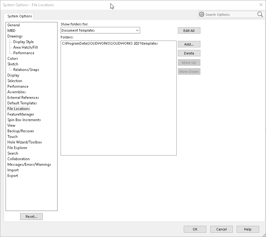

System Options > File Locations
This topic contains two tables. The information in the table:
  • appearing immediately after the screen capture of the dialog corresponds to the settings on that dialog.
  • titled Obsolete Enumerators contains enumerators that previously appeared on the dialog but are now obsolete.
Setting
Get/Set Methods
Return Value
or
<Value>
Comment

ISldWorks::GetUserPreferenceStringValue(swUserPreferenceStringValue_e.swFileLocationsSymbolLibraryFolder)
ISldWorks::SetUserPreferenceStringValue(swUserPreferenceStringValue_e.swFileLocationsSymbolLibraryFolder, <Value>)
String value
Show folders for - Textures - Folders
ISldWorks::GetUserPreferenceStringValue(swUserPreferenceStringValue_e.swFileLocationsTextures)
ISldWorks::SetUserPreferenceStringValue(swUserPreferenceStringValue_e.swFileLocationsTextures, <Value>)
String value
Show folders for - Thread Profiles - Folders
ISldWorks::GetUserPreferenceStringValue(swUserPreferenceStringValue_e.swFileLocationsThreadProfiles)
ISldWorks::SetUserPreferenceStringValue(swUserPreferenceStringValue_e.swFileLocationsThreadProfiles, <Value>)
String value
Show folders for - Title Block Table Template - Folders
ISldWorks::GetUserPreferenceStringValue(swUserPreferenceStringValue_e.swFileLocationsTitleBlockTableTemplate)
ISldWorks::SetUserPreferenceStringValue(swUserPreferenceStringValue_e.swFileLocationsTitleBlockTableTemplate, <Value>)
String value
Show folders for - Weld Table Template - Folders
ISldWorks::GetUserPreferenceStringValue(swUserPreferenceStringValue_e.swFileLocationsWeldTableTemplate)
ISldWorks::SetUserPreferenceStringValue(swUserPreferenceStringValue_e.swFileLocationsWeldTableTemplate, <Value>)
String value
Show folders for - Weldment Cut List Templates - Folders
ISldWorks::GetUserPreferenceStringValue(swUserPreferenceStringValue_e.swFileLocationsWeldmentCutListTemplates)
ISldWorks::SetUserPreferenceStringValue(swUserPreferenceStringValue_e.swFileLocationsWeldmentCutListTemplates, <Value>)
String value
Show folders for - Weldment Profiles - Folders
ISldWorks::GetUserPreferenceStringValue(swUserPreferenceStringValue_e.swFileLocationsWeldmentProfiles)
ISldWorks::SetUserPreferenceStringValue(swUserPreferenceStringValue_e.swFileLocationsWeldmentProfiles, <Value>)
String value
Show folders for - Weldment Property File - Folders
ISldWorks::GetUserPreferenceStringValue(swUserPreferenceStringValue_e.swFileLocationsWeldmentPropertyFile)
ISldWorks::SetUserPreferenceStringValue(swUserPreferenceStringValue_e.swFileLocationsWeldmentPropertyFile, <Value>)
String value
Show folders for - Appearance Folders - Folders
ISldWorks::GetUserPreferenceStringValue(swUserPreferenceStringValue_e.swFileLocationsAppearances)
ISldWorks::SetUserPreferenceStringValue(swUserPreferenceStringValue_e.swFileLocationsAppearances, <Value>)
String value
Show folders for - Light Folders - Folders
ISldWorks::GetUserPreferenceStringValue(swUserPreferenceStringValue_e.swFileLocationsLights)
ISldWorks::SetUserPreferenceStringValue(swUserPreferenceStringValue_e.swFileLocationsLights, <Value>)
String value
Show folders for - Scene Folders - Folders
ISldWorks::GetUserPreferenceStringValue(swUserPreferenceStringValue_e.swFileLocationsScenes)
ISldWorks::SetUserPreferenceStringValue(swUserPreferenceStringValue_e.swFileLocationsScenes, <Value>)
String value
Show folders for - Hole Tags List - Folders
ISldWorks::GetUserPreferenceStringValue(swUserPreferenceStringValue_e.swHoleTagsList)
ISldWorks::SetUserPreferenceStringValue(swUserPreferenceStringValue_e.swHoleTagsList, <Value>)
String value
Show folders for - Structure System Connection Elements - Folders
ISldWorks::GetUserPreferenceStringValue(swUserPreferenceStringValue_e.swFileLocationsStructureSystemsConnectionElements)
ISldWorks::SetUserPreferenceStringValue(swUserPreferenceStringValue_e.swFileLocationsStructureSystemsConnectionElements, <Value>)
String value
Show folders for - Inspection Project Template Folder - Folders
ISldWorks::GetUserPreferenceStringValue(swUserPreferenceStringValue_e.swFileLocationsInspectionProjects)
ISldWorks::SetUserPreferenceStringValue(swUserPreferenceStringValue_e.swFileLocationsInspectionProjects, <Value>)
String value
Show folders for - Inspection Report Template Folder - Folders
ISldWorks::GetUserPreferenceStringValue(swUserPreferenceStringValue_e.swFileLocationsInspectionReports)
ISldWorks::SetUserPreferenceStringValue(swUserPreferenceStringValue_e.swFileLocationsInspectionReports, <Value>)
String value
Show folders for - Inspection Default Export Folder - Folders
ISldWorks::GetUserPreferenceStringValue(swUserPreferenceStringValue_e.swFileLocationsInspectionExports)
ISldWorks::SetUserPreferenceStringValue(swUserPreferenceStringValue_e.swFileLocationsInspectionExports, <Value>)
String value
Show folders for - Connected Library - Folders
(valid only for SOLIDWORKS Connected)
ISldWorks::GetUserPreferenceStringValue(swUserPreferenceStringValue_e.swFileLocationsConnectedLibrary
ISldWorks::SetUserPreferenceStringValue(swUserPreferenceStringValue_e.swFileLocationsConnectedLibrary, <Value>)
String value
