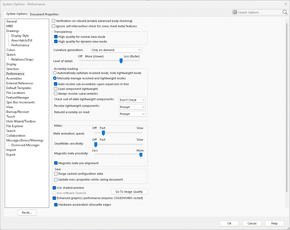

This topic contains two tables. The information in the table:
  • appearing immediately after the screen capture of the dialog corresponds to the settings on that dialog.

Setting
Get/Set Methods
Return Value
or
<Value>
or
<OnFlag>
Comment
Verification on rebuild
ISldWorks::GetUserPreferenceToggle(swUserPreferenceToggle_e.swPerformanceVerifyOnRebuild)
ISldWorks::SetUserPreferenceToggle(swUserPreferenceToggle_e.swPerformanceVerifyOnRebuild, <OnFlag>)
Boolean value
Controls the level of error checking when you create or modify features. For most applications, the default setting (cleared) is adequate and results in a faster rebuild of the model
Ignores self-intersection check for some sheet metal features
ISldWorks::GetUserPreferenceToggle(swUserPreferenceToggle_e.swPerformanceSheetMetalIgnoreSelfIntersect)
ISldWorks::SetUserPreferenceToggle(swUserPreferenceToggle_e.swPerformanceSheetMetalIgnoreSelfIntersect, <OnFlag>)
Boolean value
Specifies whether to suppress warning messages for certain sheet metal parts; for example, when flanges share a common edge and the part flattens correctly but displays a warning message
Transparency - High quality for normal view mode
ISldWorks::GetUserPreferenceToggle(swUserPreferenceToggle_e.swUseAlphaTransparency)
ISldWorks::SetUserPreferenceToggle(swUserPreferenceToggle_e.swUseAlphaTransparency, <OnFlag>)
Boolean value
Specifies whether to change transparency quality from high to low when part or assembly is moving
Transparency - High quality for dynamic view mode
ISldWorks::GetUserPreferenceToggle(swUserPreferenceToggle_e.swTransparencyHighQualityDynamic)
ISldWorks::SetUserPreferenceToggle(swUserPreferenceToggle_e.swTransparencyHighQualityDynamic, <OnFlag>)
Boolean value
Specifies whether high-quality transparency is retained while moving or rotating model with pan or rotate tools
Curvature generation
ISldWorks::GetUserPreferenceToggle(swUserPreferenceToggle_e.swPerformanceAlwaysGenerateCurvature)
ISldWorks::SetUserPreferenceToggle(swUserPreferenceToggle_e.swPerformanceAlwaysGenerateCurvature, <OnFlag>)
Boolean value:
  • True = Always (for every shaded model)
  • False = Only on demand
Specifies whether to always display curvature for shaded models
Level of detail
ISldWorks::GetUserPreferenceIntegerValue(swUserPreferenceIntegerValue_e.swLevelOfDetail)
ISldWorks::SetUserPreferenceIntegerValue(swUserPreferenceIntegerValue_e.swLevelOfDetail, <Value>)
Integer value ranging from 0 to 20
Target frame rates ranging from 0 (off) to 20 (maximum level of detail removed); for example, if set at 20, then try and get 20FPS on spin dynamics by dropping detail until rate is achieved
Assembly loading - Automatically load component data on demand
- or -
Manually manage resolved and lightweight modes
ISldWorks::GetUserPreferenceIntegerValue(swUserPreferenceIntegerValue_e.swAssemblyLoadComponents)
ISldWorks::SetUserPreferenceIntegerValue(swUserPreferenceIntegerValue_e.swAssemblyLoadComponents, swAssemblyLoadComponents_e.<Value>)
 See swAssemblyLoadComponents_e for options
Assembly loading - Auto resolve sub-assemblies upon expansion in tree
ISldWorks::GetUserPreferenceToggle(swUserPreferenceToggle_e.swAutoResolveSubAssembliesUponExpansionInTree)
ISldWorks::SetUserPreferenceToggle(swUserPreferenceToggle_e.swAutoResolveSubAssembliesUponExpansionInTree, <OnFlag>)
Boolean value
Valid only if Assembly loading - Manually manage resolved and lightweight modes is selected
Assembly loading - Load component lightweight
ISldWorks::GetUserPreferenceToggle(swUserPreferenceToggle_e.swAutoLoadPartsLightweight)
ISldWorks::SetUserPreferenceToggle(swUserPreferenceToggle_e.swAutoLoadPartsLightweight, <OnFlag>)
Boolean value
Assembly loading - Always resolve subassemblies
ISldWorks::GetUserPreferenceToggle(swUserPreferenceToggle_e.swPerformanceAlwaysResolveSubassemblies)
ISldWorks::SetUserPreferenceToggle(swUserPreferenceToggle_e.swPerformanceAlwaysResolveSubassemblies, <OnFlag>)
Boolean value
Specifies whether to always resolve subassemblies when an assembly opens lightweight; Valid only if Assembly loading - Manually manage resolved and lightweight modes is selected
Assembly loading - Check out-of-date lightweight components
ISldWorks::GetUserPreferenceIntegerValue(swUserPreferenceIntegerValue_e.swCheckForOutOfDateLightweightComponents)
ISldWorks::SetUserPreferenceIntegerValue(swUserPreferenceIntegerValue_e.swCheckForOutOfDateLightweightComponents, swCheckOutOfDate_e.<Value>)
See swCheckOutOfDate_e for valid options
Assembly loading - Resolve lightweight components
ISldWorks::GetUserPreferenceIntegerValue(swUserPreferenceIntegerValue_e.swResolveLightweight)
ISldWorks::SetUserPreferenceIntegerValue(swUserPreferenceIntegerValue_e.swResolveLightweight, swPromptAlwaysNever_e.<Value>)
Boolean value:
  • 0 = Prompt
  • 1 = Always
Assembly loading - Rebuild assembly on load:
ISldWorks::GetUserPreferenceIntegerValue(swUserPreferenceIntegerValue_e.swPerformanceAssemRebuildOnLoad)
ISldWorks::SetUserPreferenceIntegerValue(swUserPreferenceIntegerValue_e.swPerformanceAssemRebuildOnLoad, swPromptAlwaysNever_e.<Value>)
See swPromptAlwaysNever_e for valid options
Mates - Mate animation speed
ISldWorks::GetUserPreferenceDoubleValue(swUserPreferenceDoubleValue_e.swMateAnimationSpeed)
ISldWorks::SetUserPreferenceDoubleValue(swUserPreferenceDoubleValue_e.swMateAnimationSpeed, <Value>)
Double value:
  • 0 = off
  • >0 = animation speed in seconds
Specifies speed of animation for mates
Mates - SmartMate Sensitivity
ISldWorks::GetUserPreferenceDoubleValue(swUserPreferenceDoubleValue_e.swSmartMateSensitivity)
ISldWorks::SetUserPreferenceDoubleValue(swUserPreferenceDoubleValue_e.swSmartMateSensitivity, <Value>)
Double value:
  • 0 = off
Specifies the speed at which SmartMates are applied
Mates - Magnetic mate pre-alignment
ISldWorks::GetUserPreferenceToggle(swUserPreferenceToggle_e.swMagMatePreAlign)
ISldWorks::SetUserPreferenceToggle(swUserPreferenceToggle_e.swMagMatePreAlign, <OnFlag>)
Boolean value Specifies whether to enable magnetic mates pre-alignment
Save - Purge cached configuration data
ISldWorks::GetUserPreferenceToggle(swUserPreferenceToggle_e.swPurgeAllBodiesForNonActiveConfigurations)
ISldWorks::SetUserPreferenceToggle(swUserPreferenceToggle_e.swPurgeAllBodiesForNonActiveConfigurations, <OnFlag>)
Boolean value
Specifies whether to purge cached configuration data to reduce file size and save time
Save - Update mass properties while saving document
ISldWorks::GetUserPreferenceToggle(swUserPreferenceToggle_e.swUpdateMassPropsDuringSave)
ISldWorks::SetUserPreferenceToggle(swUserPreferenceToggle_e.swUpdateMassPropsDuringSave, <OnFlag>)
Boolean value
Specifies whether to update mass properties information when saving document
Use shaded preview
ISldWorks::GetUserPreferenceToggle(swUserPreferenceToggle_e.swUseShadedPreview)
ISldWorks::SetUserPreferenceToggle(swUserPreferenceToggle_e.swUseShadedPreview, <OnFlag>)
Boolean value
Specifies whether to use shaded preview
Use software OpenGL
ISldWorks::GetUserPreferenceToggle(swUserPreferenceToggle_e.swUseSimpleOpenGL)
Read-only Boolean value
Specifies whether graphics adapter hardware acceleration is disabled and graphics rendering using only software is enabled
Enhanced graphics performance (requires SOLIDWORKS restart)
ISldWorks::GetUserPreferenceToggle(swUserPreferenceToggle_e.swEnablePerformancePipeline)
ISldWorks::SetUserPreferenceToggle(swUserPreferenceToggle_e.swEnablePerformancePipeline, <OnFlag>)
Boolean value
Hardware accelerated silhouette edges
ISldWorks::GetUserPreferenceToggle(swUserPreferenceToggle_e.swHardwareAccSilhouetteEdges)
ISldWorks::SetUserPreferenceToggle(swUserPreferenceToggle_e.swHardwareAccSilhouetteEdges, <OnFlag>)
Boolean value
