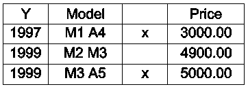

Przykład:
Tabela:
Plik eksportu (format .csv):
"Y","Model","","Price"
"1997","M1 A4","x","3000.00"
"1999","M2 M3","","4900.00"
"1999","M3 A5","x","5000.00"
