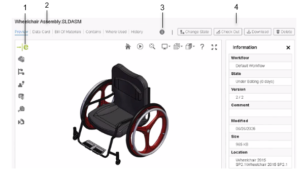

The Preview tab displays bitmaps for SOLIDWORKS files with the ability to start an interactive preview using the eDrawings Web viewer. Other common file types are converted to an HTML preview that looks similar to the native application for the file type.
To display the Preview tab, do one of the following in the file list:
  • In the file or folder list, click the file name.
Preview Tab
1 Enhanced preview icon Click the eDrawings icon, to view the eDrawings preview.
2 File Name link Click the file name link to download a file.
3 Information icon Click the Information icon to view the file information, for example, workflow, state, and version.
4 Action Buttons Change State, Check Out, Download, and Delete.
