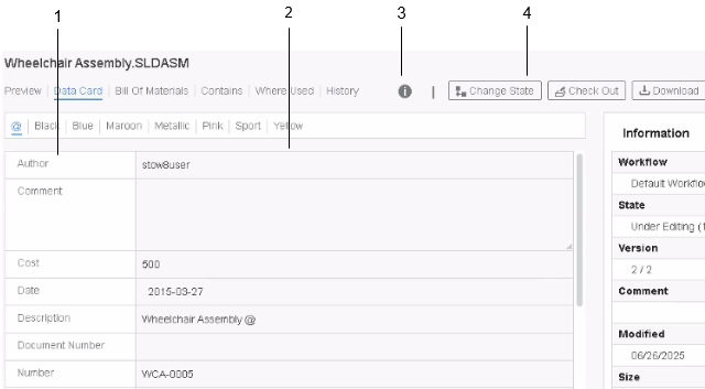

Data Card Tab in Web2
The Data Card tab displays the card variables and values for the selected file.
To display the Data Card tab, do one of the following:
  • Click the file name and select the Data Card tab.
Data Card Tab
The Data card is displayed in either a flat or tree layout, depending on the option selected by the Administrator in the Web Card Configuration Editor dialog box in the Administration tool.
1 Variable names Displays the name of the variable as defined by the administrator.
2 Variable value fields Displays the value for variables.
3 File Information icon Click . Displays the information of the file, for example, workflow, the current state, and the version.
4 Action Buttons For example, Change State.
Web2 does not support images and control logic.
