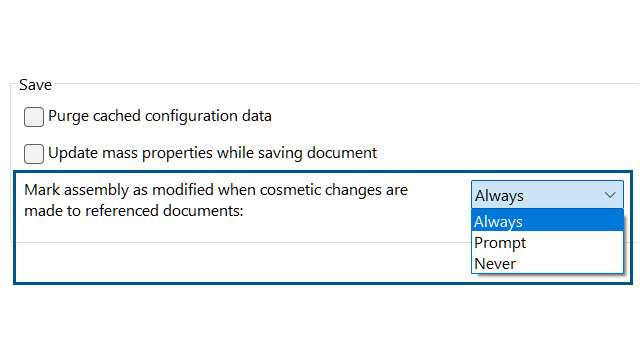

To specify rebuild requirements for cosmetic changes:
  1. Click Tools > Options > System Options > Performance.
  2. Under Save, select Mark assembly as modified when cosmetic changes are made to referenced documents and select an option:
    Always Rebuilds the assembly for all cosmetic changes.
    Prompt Asks if you want to rebuild for each cosmetic change.
    Never Does not rebuild the assembly for cosmetic changes.
