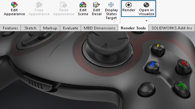

Render with SOLIDWORKS Visualize from SOLIDWORKS If you have a SOLIDWORKS Visualize installation with a license, you can generate high-quality photorealistic final renders from SOLIDWORKS using SOLIDWORKS Visualize. The RenderTools CommandManager includes the following tools. Render Generates high-quality renders from SOLIDWORKS using the SOLIDWORKS Visualize Render PropertyManager. Open in Visualize Specifies options that load a SOLIDWORKS model into Visualize. Contents Rendering with SOLIDWORKS Visualize from SOLIDWORKS Loading SOLIDWORKS Models into SOLIDWORKS Visualize You can load SOLIDWORKS models directly into Visualize and adjust them further using Visualize functionality. Parent topicSOLIDWORKS Fundamentals Changes to System Options SOLIDWORKS Appearances Deleting Equations for Sketches and Features 3DEXPERIENCE Transition Task in SOLIDWORKS Task Scheduler Application Programming Interface
