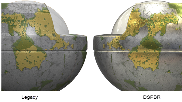

You can use a more extensive library of appearances in
SOLIDWORKS® through
Dassault
Systèmes' Enterprise PBR Shading Model (DSPBR).
These
appearances are consistent with SOLIDWORKS
Visualize
and the 3DEXPERIENCE platform and result in more realistic
visuals.
You can render appearances with DSPBR, which is
enabled by default when you have Enhanced Graphics Performance. The rendering lighting
model includes high dynamic range
and
image based lighting for more
physically
correct depictions of
lighting.
